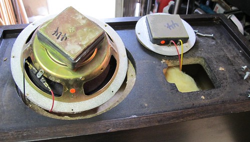

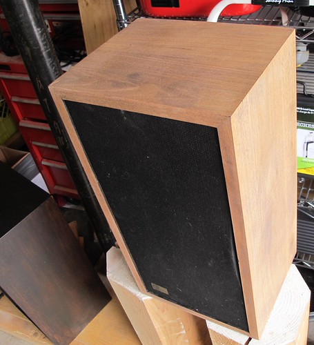

One of my weekend projects was this pair of M100s I picked up late last year. I'm not done yet but boy do they look better without that weird black paint on them.
EPI M100 5 by Buhduh, on Flickr
EPI M100 2 by Buhduh, on Flickr
EPI M100 drivers by Buhduh, on Flickr
EPI M100 3 by Buhduh, on Flickr
EPI M100 4 by Buhduh, on Flickr

Looks great. It's hard to tell in the pics, is that oil or poly?
I think it's tung oil. I was using it on something else around that time too.
I later changed all the drivers. They have the appropriate woofers from Human Speakers and the newer EPI tweeters with the gold ring.
Maybe I'll finally go get the screws I need. I plan to glue magnets to my covers and have black flat head screws in the corners that they will stick to.
