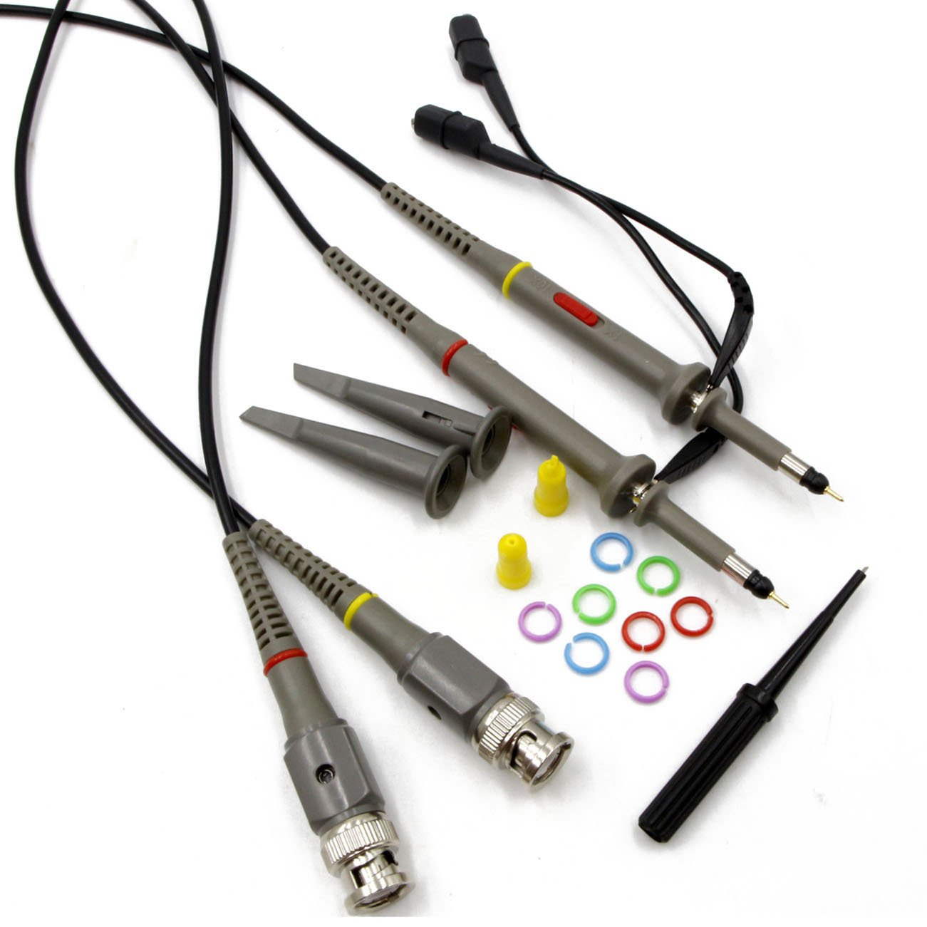

I'm still green in that area but I'm looking into buying a scope and learning how to use it.I had an old heathkit scope but the tube went out and I want to find a newer one anyway.
Willy, you are on the right path with buying a scope.
I've had a few old crt based scopes and they sure are nice
and heavy
Fews thing to consider after so many years update to better tools.
You'll require probes which allow you to tap into signals without interrupting path,
you'll know this probes as soon as you see them, they have 3 ends each. - 2 for tap signal and one plugs into scope.
https://www.amazon.com/RioRand-Osci...rd_wg=3GSrH&psc=1&refRID=M1641H5MJPM71N65JA1Q
Also Scope have channels and it's nice to have many channel but for starts, 2 channels is minimuns so that mean
you will also needs 2 set of tapping ability probe.
For audio, 30meg might work ok for price if it comes dual channel with 2 set good probe.
Rigol makes good scopes, not cheap - to upgrade to a good used scope, go higher frequency ($$$) with 3 or 4 channel.
Rigol DS 1054 or similiar would probably be more than you'll ever need.
Rigol has update able software that can make it do tricks of more expensive scopes
-user hack/update able.
