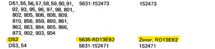

Diode D52 is measuring SHORT!Mine is called PCB-2
Now to find one or an equivalent. I checked my very limited supply of Zener's and all I have are 1n4755a and 5242bDiode D52 is measuring SHORT!

yes 0 volts. Pulled the diode and checked it on diode checker and measures short both ways.So you measure 0V (vs 13.5v) on the Zener here?
From SM PL:
1N5242B is a 12V/500mW Zener, you need a 13V.
Not sure where I will find a replacement as it does not seem to be common.So you measure 0V (vs 13.5v) on the Zener here?
From SM PL:

I think I will order the correct one.Try your 5242b, it might be fine. If it blows up again, go with any available 14-16V zener as a replacement, like this one.
