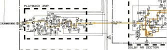

About the schematic: It is available at hifiengine.com If you haven't yet just subscribe, it's totally free. And lucky you, there is an excellent schematic available there, with a neat coloured line for the audio signal path! Here's a detail to give you an idea.
It looks as if there are many separate PCB's in this machine, so you could do a fair bit of diagnosing here without using any measuring instrument at all. This is exciting new stuff man!:D What you could do is simply cross the wires between left and right, between two sections. Like here between the playback amp and the dolby amp (or section). Do you now have sound on the left, but not on the right? Then the problem must be somewhere before the dolby amp. Still no sound on the left, but only on the right? In that case the problem must be after the playback amp. You go systematically along the signal path, and that is how you determine from whereon switching the input left and right makes a difference. We'll take it from there.
Thanks guys! That schematic is great.
When you say cross the wires at various points, does that mean unsoldering and resoldering? Just not sure how I'd easily switch the wires / channels.
Yes you might have to unsolder wires, or switch the pins in a connector, or whatever gives. Bare in mind that a wire connection is just that. So you can either temporarily or permanently replace it with any piece of wire that is more convenient, as long as it connects on both ends.
