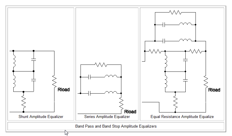

Krytar,
Here's the amp equalizers I have implemented in PCFILT. Look at the first two examples under amplitude equalizers. I have the three described as "lowpass equalizers"
http://www.filter-solutions.com/passive.html
The second set described as bandpass equalizers look interesting. For bandpass filters I would normally cascade two of the "lowpass equalizers". PCFILT can handle up to 10 as I recall.
I have never heard the term "inverted-half-sine/slope". Can you pint me to some examples? I'm guessing that refers to a single dip in attenuation maybe?
BTW: What were you unable to analyze? The equalizer example I posted earlier wasn't worth analyzing! :thumbsdn:
AL K.

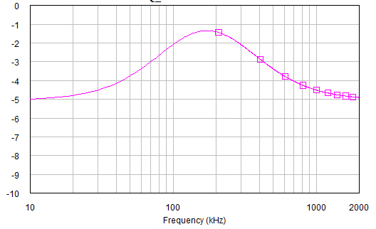

Al,

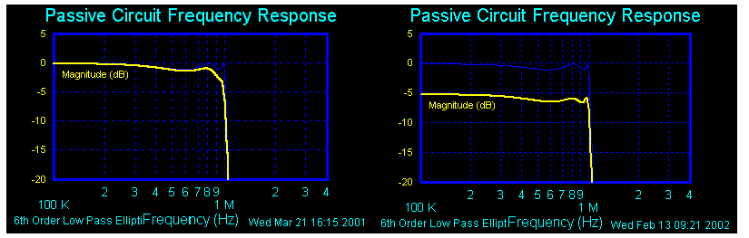

The term "inverted-half-sine/slope" is for an EQ that can do both Negative/Positive Slope or One Peak (not Dip). I can manipulate it into many different shapes, here is the example of the EQ will do the same job as it shows on the website you provided.
The picture shows a LPF before & after being equalized. Pay attention to the edge (roll off) of the pass band before and after to see how it dropped only 2 dB while the rest of the passband dropped 5 dB.:
Here is the EQ (narrow band Inverted Half-Sine) that used to equalize the LPF:
Krytar,
Ok.. That's just a fancy name for what I have always done. It's just a series "tank" with a resistor around it is sereis, or a parallel "tank" with a resistor in sereis connected in shunt. The fancy circuit is just a constant Zo version of the same thing. It's what that web site calls "lowpass equalizers".
Al K.

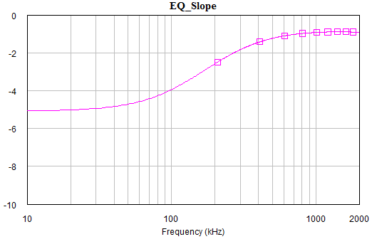

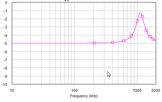

From that same EQ, by changing the L/C ratio , while maintaining the same level of attenuation (means didn't change the resistor values), A broadband Half Sine (look like a mountain) EQ is obtained. Use this to equalize "dips" or "valleys" of the response:
With that same EQ & move the resonance around, now we can obtain some negative slope response:
All of the above can be accomplished with one L/C network & 2 resistors, while maintain constant impedance across the frequency range, not as complicated as shown in the website:
Hence, the EQ can be called "Slope" (either "positive" or "negative", depends on which side of the mountain to be used) or "Inverted Half Sine" (or just "Half-Sine", up to the consumer :D)
