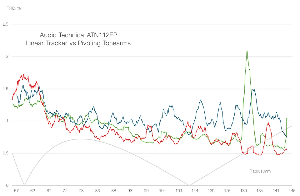

He has not understood that the calculated tracking error curve is at much higher level than the Sperling record is recorded at, and that other distortion components swamps the tracking error. Has he any clue of the zenith and inter channel phase error?:
I don't see any value in this "test", besides the sales pitch.
Neither they use the same drive/turntable with all four arms, nor do they use one and the same cartridge...and they compare their new arms, mounted to whatever drive (new, I guess) to a 45 years old turntable.

Hi, I have read the Korf blog again to make sure I was reading it correctly, from my take.
- He has used the same cart for all tests a ATN112EP (presumably Elliptical)
- Do you mean he using a 45 year old T/T with a linear tracker arm, The T/T will not make any difference to the test results. If the Linier Tracker is that old, provided it is well maintained, that also should not make a difference to the results. I use a refurbished 50 year old T/T as my main deck.
- I would not think he is using the results as promotional material, because his arms results 9with the exception of the U/Hang arm) are so were near state of art. I am amazed that the U/Hang are is so consistent across the range, especially with what has been posted previously on the down sides of this type of arm.
- Perhaps he will now come out with his own official U/Hang version, if he does I wish him the best of luck.
right, considering the velocity and RIAA preamp, the distortion is would be about a third of his estimate – and that is with some alignment error considered. A perfect alignment would have even lower tracking distortion.

To that there is crosstalk. Crosstalk is at best ≈-35 dB and phase/zenith between L/R matters.

They stated that themselves in the initial post/test.
So...not the same turntable and cartridge were used.
What worries me is his comment that "Curiously, practically every single person got the answer wrong! Here's the correct legend: Red is a linear tracker. Blue is TA-SF9R."
Er, so people couldn't work out instantly that the trace with lower distortion came from the linear tracker?!
Oh dear...
Hi, What's even more surprising is that people have not worked out or commented the the 10'' Under hang arm give the most consistent (level variable) result of the 4. (Black Line). Even thought it was not set up to an optimum position & he cannot understand why.
Cheers
Cheers
It has the highest distortion of them all, which is not strange.
Do they explain the large tracking THD of their TA-SF11R (11") arm at 132mm (green line)? That really stood out on the graph. It looks like inner tracking distortion to me. :idea:
I noticed that as well. Also, the underhung arm has the lowest distortion of them all at the inner groove, whereas the LT has the highest. I wonder what accounts for these anomalies?

The fact that the distortion all across is no higher than any arm at the inner groove may be why it's considered benign by the advocates....the LP has consistent distortion across its entirety rather than just at the end, perhaps making it less noticeable.
Don't those advocates listen to the last song of each side?
