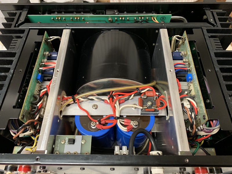

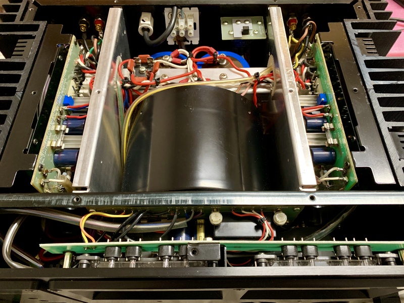

The amp is working fine :). Bias and meters are already adjusted. I'm going to do some more tests and I will post some more pics.

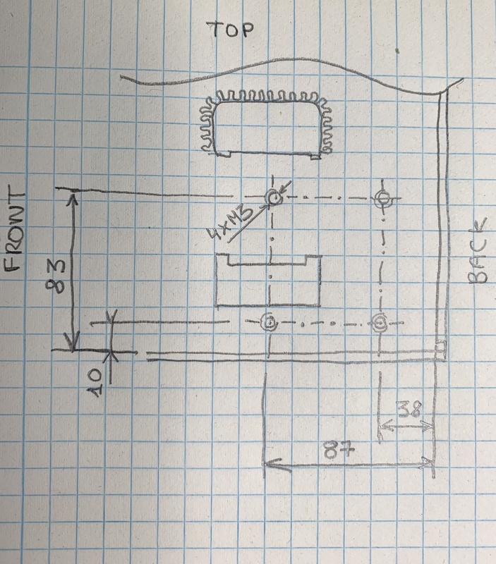

Something I forgot to mention. With the UCC caps the screw that holds the bridge rectifier must be shortened, it touches the capacitor.
Great work! Now that you've finished both units, how do you like the amps? I also reworked two p2200s and am very happy with how good they sound and perform. They are the best sounding amplifiers in my collection (most musical, IMHO).
They are excellent amps, very musical, I like them a lot. One of them are now powering my JBL subwoofer, it outputs a very nice bass, well controlled and with enough power. They are my favourite amps along with the PC2002M
