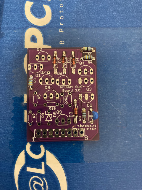

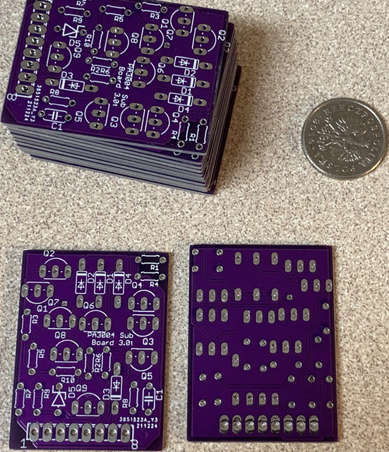

I have an SX980 that I’m quite certain has a failed PA3004. The solution by alex and @merlynski looks awesome, and possibly more reliable than the few old stock parts found on eBay. If I could get a through-hole version of the PCB I’d be willing to build it and confirm it works on that model. Unless I missed something so far it’s been successfully tested on the SX780,880,1280, and SA-7700.
@mark long may have some extra thru hole boards! Otherwise I've been meaning to build out some of the extra SMD boards I have to make available- I'll try to get to it this weekend and let you know!
--Alex
--Alex
i have boards, PM your needs
Wow, this is incredible! I just started having my relay protector click in & out randomly on my SX-780. Thank you for all this work!
