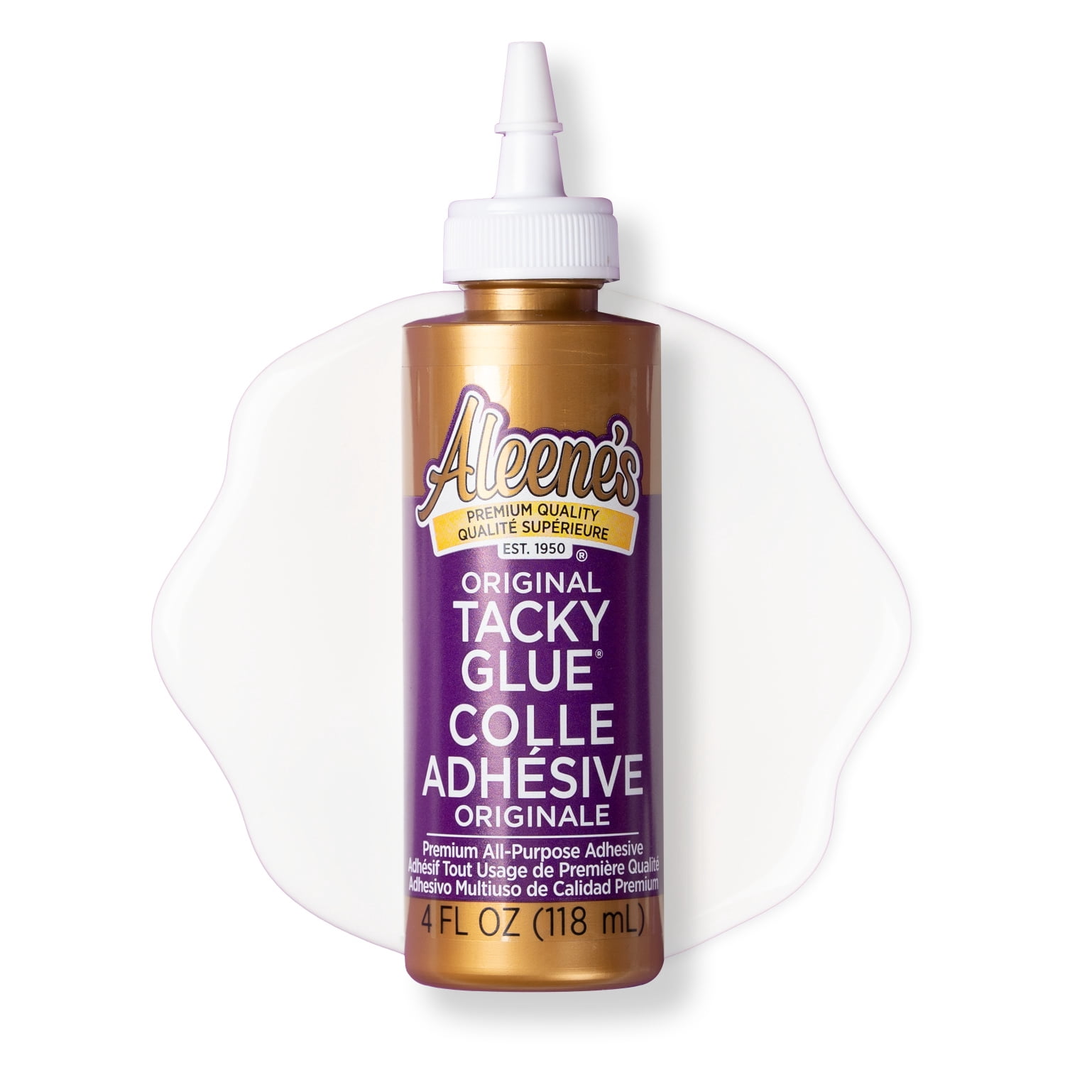

i am wondering what do you guys think is the best glue to redo surrounds??
Aleene's Tacky Glue has worked wonders for me. The texture is similar to carpenters glue and it cleans up easily and dries clear and flexible.
Available at Michaels, Walmart, Amazon etc.

After much research with both AI and forums, I found a different potential issue with using a PVA glue. The woofer cone in the PS-1000 is allegedly made of polypropylene. Something like Aleene’s for sure works great on paper and cloth, but there is debate when it comes to using it on polypropylene. Many swear by it, others say the surround peeled off. One poster said, “Adhesives don't actually chemically bond to [polypropylene], but depend on a mechanical ‘fit’ at the near-molecular level. It is also hydrophobic, so tends to repel water-based products.”
Gemini said, “Polypropylene is non-porous; water-based glues can't chemically bite into them, relying purely on mechanical surface tension, so the solution is to scuff the mounting lip of the Paradigm's plastic cone with fine sandpaper to give the water-based glue something to physically grip onto.” So it sounds like the key is to thoroughly remove the old adhesive and then properly prepare the surface of the cone.
One person found Aleene's Turbo Tacky Glue to be easier to work with because it set up and dried faster than the regular Aleene’s. But either way, it’s important to allow a full 24 to 48-hour cure time before blasting the subwoofer.
So although using a solvent-based glue sounds like it’s better suited for a polypropylene woofer like mine, I live in an apartment and therefore can’t leave it outside for two days while it dries and the VOCs dissipate. So Aleene’s it is! (And for those who told me that in the first place, this is the process I had to go through to accept that recommendation.)
For those who have used Aleene’s, have you found the need to keep finger-pressing the surround to the cone while the glue dries for 10-15 min? Any other tips?
