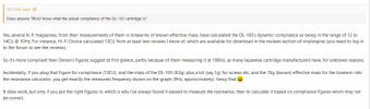

crazy how Hifi is all about people divided into two camps:
1. you can only trust your ears (snake oil, cable sounds, amplifier sounds, etc.)
2. you can only trust measurements and data
then there's Vinyl, where some will insist that the "data is wrong" and "you cannot trust your ears" both at the same time :D
All you can rely on is anecdotal BS with no basis whatsoever..
Actual measurements were done (fck the 100hz vs 10hz dispute..)
Turns out, the 103R is perfectly happy on a YA-39 with 13g headshell (we're talking 22g effective mass already. Mine has 24g effective mass (maybe even 25g with the screws of the headshell) and still sounds great. Your 30+g numbers have no basis whatsoever in any scientific measurements or otherwise.
excerpt:
