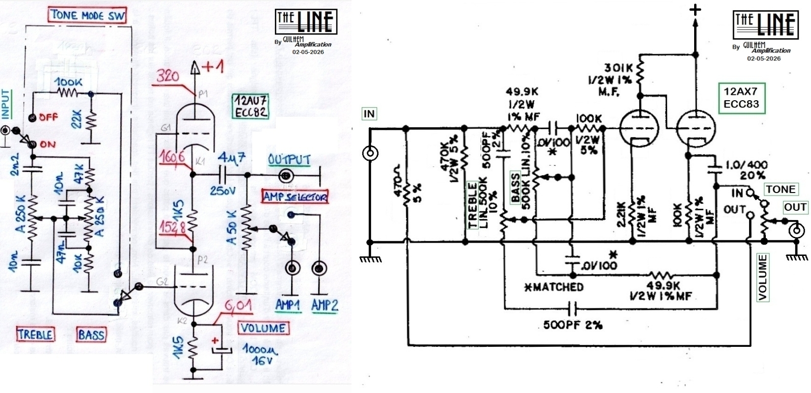

I guess that the Little Schiit BUF is designed with a tube gain circuit possibly similar to yours in front, followed with a lo-Z SS output buffer, with selectable gain attenuation.
I have some ideas on how to build my Tube Buffer...
... When I will have time to do it ! :rolleyes::)
