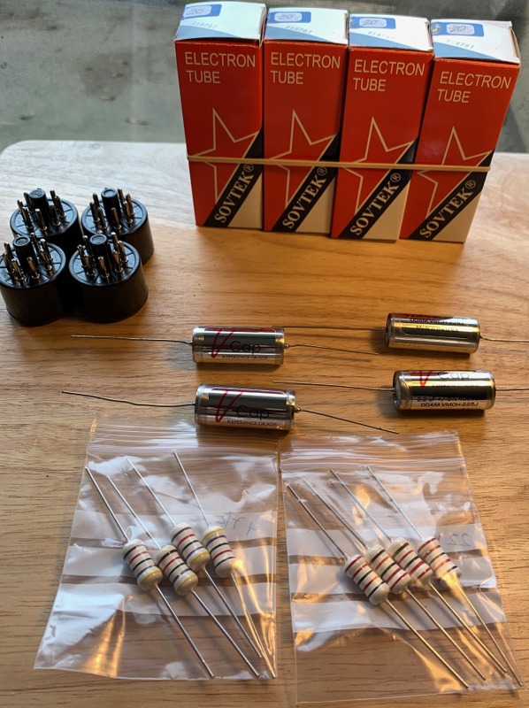

A buddy of my son did a few 'upgrades' on his Freya+ mainly because he can :) (Good Income, Audio Hobbyist & Electrical background w/nice bench)
Bottom line: I'm guessing he put 70% of the Unit price into these upgrades
Maybe I will get to listen to it soon

Even though Schiit gear is affordable, it's very well built, and deserving of mods. I'd love to hear about the particulars of the upgrades, and any improvements to sound, once you get a listening session. :)
We will have one (upgraded Freya+) in the family soon... I hope if nothing goes wrong
Don't make fun of those TUBES
We hear they are good synergy :rolleyes:

So... Yesterday I opened up the Freya+ and desoldered the 8 resistors and 4 caps with Hakko FR-301
After work and dinner my son came by and picked up the main board (only board really) - Took it over to his friend and they soldered in the new stuff
4 x 22K 2W Audio Note Silver Tantalum Non-Magnetic Resistor
4 x 47K 2W Audio Note Silver Tantalum Non-Magnetic Resistor
4 x 2.2uF 400Vdc V-Cap ODAM Capacitors (matched)
Brought it back 4hrs later... Son said they had an unexpected problem. Resistor leads too large but his friend knew what to do
I then resembled. Put in new tubes (Matched & Balanced) w/socket savers... Retired for the evening
Got up early and excited :D So far so good
Well... with about 15hrs in I believe some differences are apparent. I played my usual 'test' songs last night and heard better clarity in the upper mids and highs. Just more crisp and clearer... sharper.
Bass about the same
Sound stage deeper yet not as wide as before.
One good sign... With Vol on Freya+ 100% (no signal of course) the tweeters are dead silent. Good tubes ?
Playing radio as background music this morning getting more hours in (if that matters now) :dunno:
Well... with 50+ Hours
The Sound Stage is back to being well outside of the speakers maybe a tad higher up. Certain songs/recordings have that WTF :eek: wide & high SS
As most of us know at some point diminishing returns really kick in... The Freya+ is a better PreAmp now but was it worth the EXTRA $$$ ??
