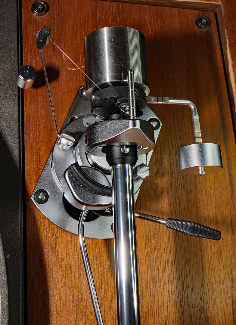

That's your anti-skate, and it should be actuated from the left side of the bar protruding from the tone arm. It ain't working right now.
@UncleAng is correct! Look at the user manual you were provided and you will see how it should be arranged so that it will actually work. Basically, it applies a force to the arm that counters the inward force towards the end of the record, essentially in an effort to keep the pressure on both the inside and the outside of the groove as equal as possible thereby avoiding (or seeking to avoid) inner groove distortion.

Should look like this..... hard to explain when written,
I have never seen an anti-skate mechanism like that. I guess a torsion bar(s) setup. Wow!
You're correct, as the arm moves across the disc it applies more AS... I guess regardless of VTF?
Are there different bar diameters or lengths for the different vertical tracking forces? That's the only way I know to change torque bar forces (à la old VW bugs).
Hey Booch, wondered about that myself.....I see what appears to be a cylindrical weight on one side of the device that might have threads, allowing it to be moved inward or outward which should, or might, affect the force of the bar on the other side......:idea: Hard to say without the manual, but since the OP has that he should be able to identify the form and function of that AS device.

Very interesting design. The only one that I've seen on a turntable. Talk about "unique" suspension designs ...let me tell you about the French and Citroën.
That's very interesting. However, this seems to be one of the manuals that aren't translated properly for us to understand the intended message. I, and maybe it's just me, don't know exactly what "automatically adjustable" means because if it's automatic, then why is it adjustable? Had it said, "adjusts automatically," I would better understand. I'm still wondering if one needs to do anything to that "automatically adjustable" weight seen on the opposite (kinda) side of the bar?
Very surprised you have not seen this type of a/s. There are lots of them around. Both sides of the tonearm, usually two long arms on the pivot with a sliding weight on one to allow settings for different tracking forces. There were also ones with the rotational piece connected to the tonearm by a nylon string but same sliding weight on a pivoting device.
I don’t think this ‘more as’ is completely correct but I’m not going to get out my Statics/Dynamics text books and relearn the vector calculations to see what really happens. I just think that as the weight is moved up to nearly 90° close to record center the vectored force applying AS would be less compared to the start of the record where the weight was about straight out from the pivot point.

I've always thought that the AS force should increase the closer it gets to the center of the record to compensate for the force being generated by the inward movement of the stylus.....or maybe we're saying the same thing?
It looks in this photo like the lower rod is defying gravity. Is this an optical illusion or is it tightened in some way that keeps it against the other piece? Mine hangs freely and there does not seem to be a way to tighten it
Lower rod pivots, upper rod is fixed. Upper rod slides across lower rod as tonearm swings towards spindle.
