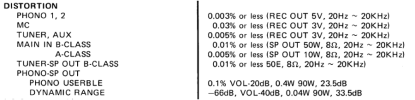

Are you saying that the CA-1010 in the simulation doesn't meet these specs:
CA-1010:
CA-1000:
CA-2010:
Sorry if I was unclear. My reference was with respect to the CA-1000 since it is the subject of this exercise. The only parameter that I looked at so far for the SA-1010 is the THD in class B mode at 1 KHz for rated power and it did perform better than the 50W spec that you posted. But that's before factoring in some power supply sag. At 50W output, I expect that the -1010 should easily exceed specs.
