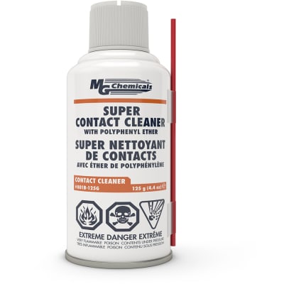

This is what I use. Have used it on Marantz 7C, 8B bias pots, and many other vintage components with great success and no problems.
