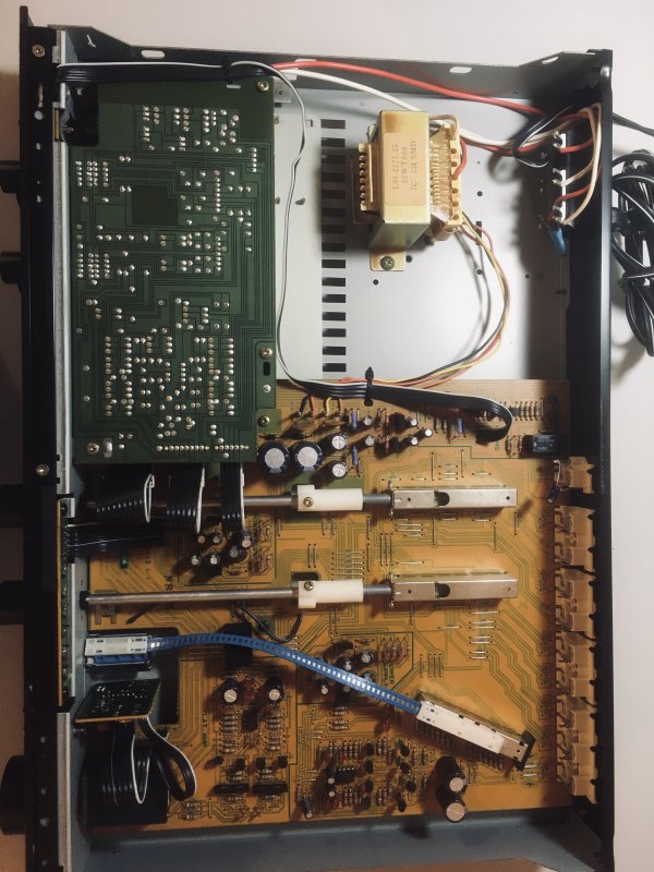

My balance potentiometer was physically damaged so could not be rebuilt. The Alps LPS 704F 250K dual balance pot is functionally identical to the original, but 6mm larger in diameter. It can still fit in the space of the original, and is by the way a better quality component. The LPS 704F solder tabs are larger and spaced wider apart, so the pot body must be rotated away from the board, then wires soldered to the board as shown in the photo. Since the replacement is functionally identical to the original the only difficulty is finding a neat wiring solution, I used the two ribbons shown in the photo. That's it pretty easy no secret about it.View attachment 805570
Hi everyone. Thanks for all the advice. It was tricky but I was able to successfully rebuild my balance pot on my c2. (somehow I reassembled it upside-down but.. whatever haha)

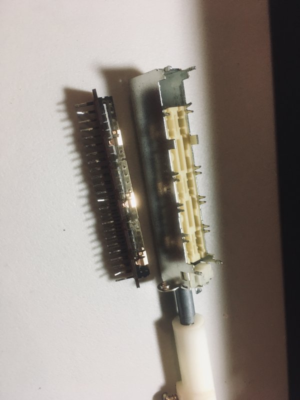

I am still having occasional issues due to the input selector being dirty. How do you clean that part? Does it get sprayed in the large blue box area? It didn't look like the standard pentameter I am used to spraying inside of the small hole.
There is really no way to tell you how to clean the selector switches. They must be de soldered from the board marking what one goes back where and disassembled. The internal parts need be cleaned, lubed and everything soldered back. They are time consuming and tedious is the word...

I use Deoxit and plain printer paper on the copper contacts. I let the contacts sit a long time in the Deoxit before using the paper thru the contacts. Very careful with those. They are very small and will disappear on you. They will also bend if you rough house on them. One switch has more positions than the other but they look just alike. Use care to put them back where the came from ! On the metal rails, contacts that connect to the pins (whatever they are called) come in green sometimes ! The oxidation can be pronounced. I use yes, a # 2 pencil eraser on them until I found a "Dremel" tool attachment that had a felt polisher attachment/tip and then I used it with metal polishing compound. That made the job much quicker and easier. Once again..care is the order of the day. I used dielectric silicon (clear) on the rails after the polish. I used solder braid to de solder it all. The pads are tough. I attach one side of the de soldering braid to one of the end of the terminals and followed it all the way down clearing solder at each terminal as I went. Please wet each terminal with new solder first or use rosin. May well use both. On the switches, you have to take them apart right ? Use a very small screwdriver like a watchmaker size but not a tiny one and pry the part that looks like a Y towards each other. It is much more simple than it seems but hard to explain. Those switches are 1: Tough. 2: Very good quality. Take your time. Photograph your work. Do one switch at a time (unless you are impatient like me). Make sure you take in to account where all that stuff came from and put it back. Last but not least. There are phillips screws in the nylon/plastic (whatever it is) connectors that fix the switch to the control rod. Not too tight with those sir. You will see that it takes very little tightening for those to stay in place. Even if you do not get them tight enough the worse that can happen is you will need take the hood off and tune on them a bit. Tighten them too much and well, you know what happens... No need in trying to align all this stuff till you get it all back together. You will see how simple it is to align the knob with the switch using the philips screws , the nylon/plastic spacer and the switch set all the way right or left . I hope you enjoy this project. I did. In fact I have two more I am going to rebuild.
Thanks so much! This makes me feel much braver about taking it apart to clean it. The metal underside with the pins just snaps out of the plastic/metal housing?
Absolutely not that is what you need the small screwdriver for the metal tabs have to be bent. The metal tabs start out looking like a y when you are done they should be parallel to each other like a Roman numeral 2.

Thanks! I actually had a chance today to dis-assemble it and clean the selector switch. Overall it went pretty smooth. Thanks for the tip on using the braid.. I had been using a solder sucker before but that was obviously taking waayy too long on those long caterpiller-like selectors.
Thanks for the tip about shooting dexoit through the back. This selector was super corroded though so I am glad I took it apart. Was pretty much totally turned black on each end! Had to go for the eraser, rubbing alcohol, and finish with the dexoit. Used a toothbrush with rubbing alcohol for the rails.
Thanks for all the help, I could not have done it without the pictures and directions! Overall it was easier than rebuliding the balance switch, although it took a little bit longer. Probably 5 hrs start to finish.

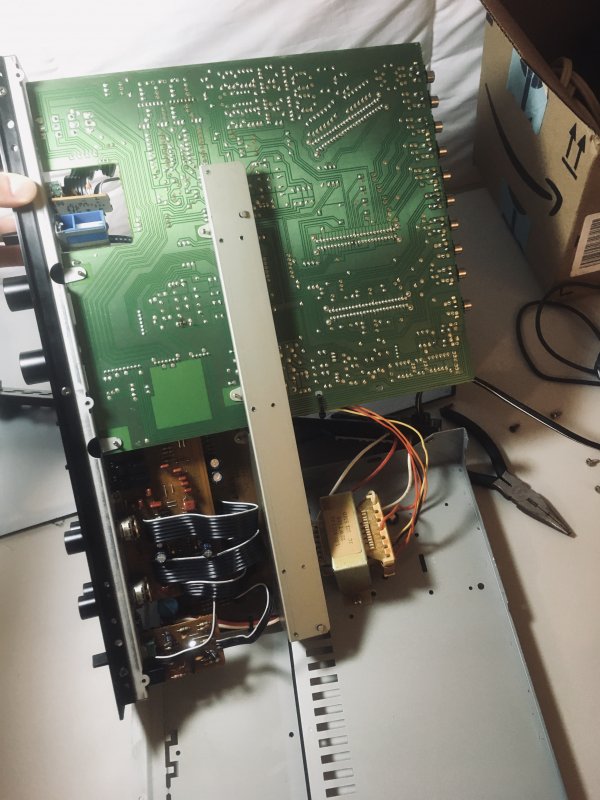

Oh just something I noticed, I was able to carefully flip the board over without disconnecting the transformer. It was a little tricky with the angles but overall not too bad. I just happened to notice the transformer was disconnected in one of your photos, although admittedly it looks a little easier to work on like that and reconnecting the transformer is not super difficult.
A lot of work can be done with out disconnecting the transformer. With the work that I do when I have one apart for a restore I take it all apart. I Love the C2 amplifier so when I do one I do it all the way thru. I have never done one as far as upgrading/moding circuits though. Never used any fancy capacitors or anything close. To be honest I do not have the time, inclination, knowledge or money for that. They sound so good with a proper recap, cleaning and op amp upgrade (with standoffs) that has been good for this one .... So far anyway, who knows one day ?? Glad to help. If you took pictures why not upload a few. I would be happy to see them .Oh one more thing, congratulations on getting yours done and thanks for saving another from the scrap heap !
Ah gotcha. I figured there was a good reason the transformer was disconnected. Oh just wondering when you recap do you do all of them or just a couple major ones?
