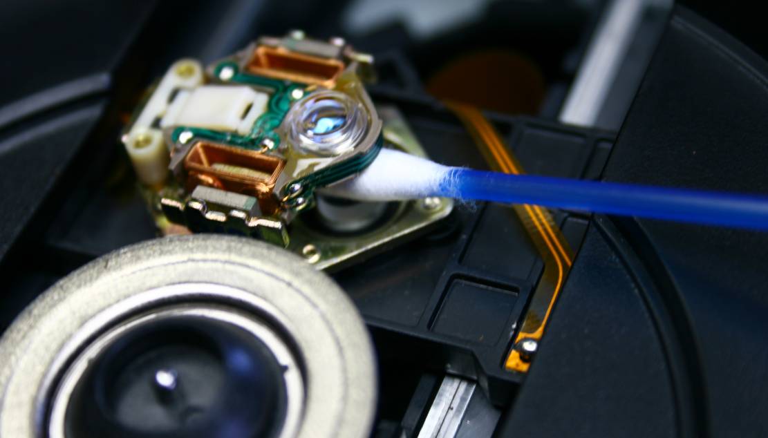

Going back to Lampy's orig. Laserology article, one particular image might be relevant to the issues with my Kwd dp-47 laser issue:
The Sony heads were not sealed (unlike Philips, which were). But I'm not sure how big of an issue this might be. My KSS-152 looks clean, and the Kenwood dp-47 was very clean inside and out when I acquired it.
So, while the Q-tip maintenance might make for impressive photography, I'm not sure how REALLY useful these, ahem, tips by Lampy REALLY are. And certainly, all the surgery with delicate coil wire is cringey AF. Yikes, Lamps!
