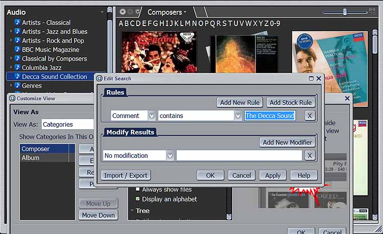

Lots of different ways to organize, and don't forget ... I'm Polish ... my mind works in strange and mysterious ways! <G>
Anyway ... here's some samples. Nothing fancy, and most (if not all) of my folders are built the same way. Decca Sound is the basic template ... that was the first one I did here. Right click on the AUDIO folder and create and name a new view ... I've already at this point added a COMMENT tag for the collection as I rip each CD.

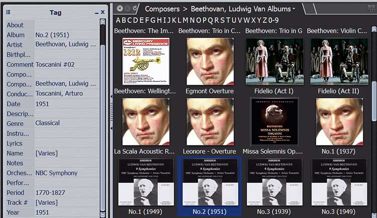

The Mercury collections are similar ...
One thing I did with those was modify the comments to include the individual CD numbers as I ripped the disks. The "rule" in this case just gives the "MLP1 - CD" so it catches all the CDs in that collection. "MLP2 - CD" is of course used for the second collection.
Toscanini is the same, only that's got composers scattered all over the disks. Instead of album covers, I downloaded generic pics of the composers for the library. Works for me anyway. Here's where I got the pics ...

How does that interfere with my master view which I have set by date of release?
Custom folders won't interfere with any other views you may use or have created. One of the benefits of MC is there's many ways to find and organize the same album. One peg ... many holes. There's also the universal search if all else fails.

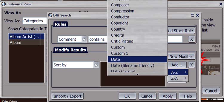

alright, I created the folder from "empty view" but it put all kinds of stuff in it. I had to delet the folder, it was not what I wanted at all.
Do I need to tag the albums in some way? I can just drag and drop like user friendly windows?
all i want to do is get all my Virtuoso albums in one feakin' folder, then by date.
JRiver may be great but it's a monster to learn. At least for me. Guess my genius test scores are no match for JRiver. :no:
Click on TAG in the ACTION window, then scroll to comments and add "Virtuoso" to every album you want in the list. Here's the settings for the custom view that should work for you and capture all the albums you've tagged.
Any other custom views, same thing, only different. Only tricky bit is when you "modify results" click ADD and hover the mouse pointer over A-Z ... the list of fields you can use will pop up, then scroll to whatever you wish to use. In this case, you'll end up with all the Virtuoso tagged albums listed in chronological order, assUming they're also date tagged properly. You'll also still find the albums in any other views you could find them in before.
Once you've got the basic view working right, you can TAG individual files or albums for additional information (like lyrics, orchestra, etc.) on the fly, even during play.
Something like this is where MC's custom views shine for me. I think I've mentioned this before, but I seldom change the original filenames and such ... I do most of my tag editing in MC, which stores it's own tag information in an internal database and doesn't change what your operating system sees. Example ... here's what part of the Toscannini box set looks like in Windows Explorer:
