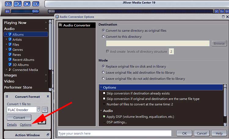

Perhaps it would be best to convert the format to FLAC first by using Tools>Advanced Tools>Convert format. Then don't forget to delete the WAV file once you are done. I would just experiment with one track first and get the process down.
You can then just edit the track (name) of your new FLAC file by right clicking and rename. That will name the song, then do the same with the other fields and after select artwork (I use JRivers internet search which is based on the Artist and Album fields. As for placement of the track files in the correct folders, use Windows file management. JRiver scans for changes each time it is opens and will find the track in its new location so with just a restart of JR it usually finds the changes almost immediately. Hope that helped.

Don't have to re-rip the CDs ... just convert the "library" in jRiver. Open AUDIO - ALBUMS ... that shows all your music. Select one album to point at the list, then hit [CTRL]A to select everything, then use the CONVERT tool.
Probably not a bad idea to empty your Recycle Bin first. With the options selected, jRiver converts each file, then automatically sends the original version to the Recycle Bin. I'd also recommend having a good backup of your WAV files, just in case something goes horribly wrong. Your call there, as jRiver has a pretty trusty conversion process - I did the same thing for all my WMA lossless files way back in the day.
Once all your files are converted, you can do the same thing to select all files for the ANALYZE tool.
You MAY also have to do the same thing to select all files, then LIBRARY TOOLS/LOOKUP TRACK INFO FROM ONLINE DATABASE if your having problems with tags as mentioned. Not sure if jRiver does this automatically, but make sure you're online when you do the conversion, just in case. Files with good tags SHOULD be automatically skipped, but don't quote me on that. When I did my conversion, all I had was the album, artist, and track name to work with.
