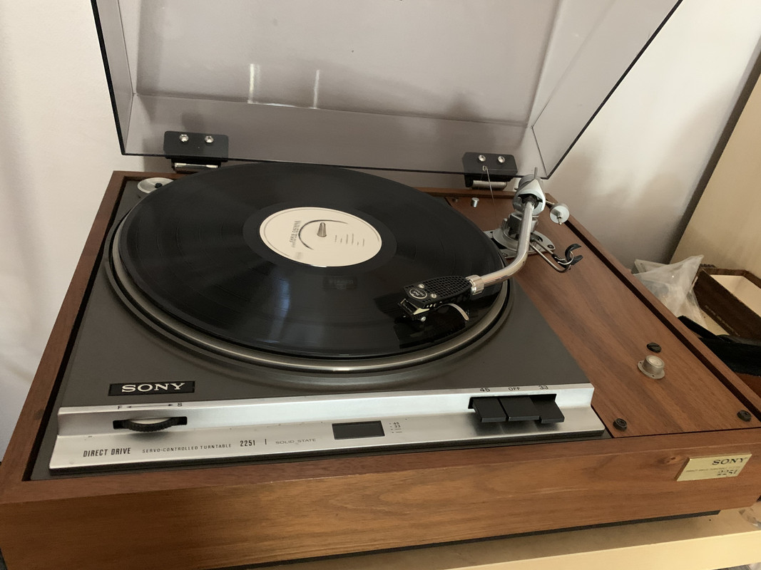

Hi! Reviving this old thread. Does anyone know of a replacement dust cover with correct hinges? Is there another Sony model that uses the same one, opening up my chances of locating a dust cover?
Thank you.
I lift mine on and off, it's a generic cover.The hinges are hard to come by,I had a pair once and sold them to a member that says he'd been looking for a long time for a set to come up for sale.Patience and a WTB post should help.Love my 2251.
