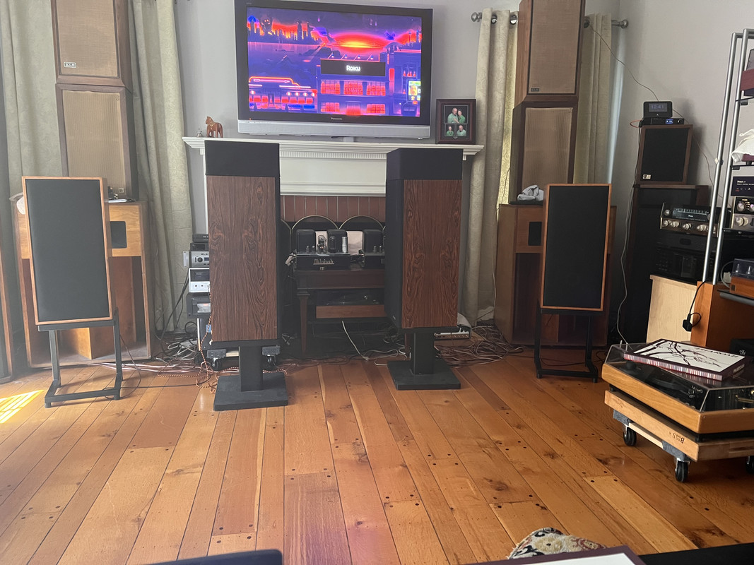

Reviving to add my testimony to this statement. Just acquired a beautiful pair of BC-1's courtesy of AK'er @Fairlane last weekend, and teamed up with a McIntosh MC225, all my several pairs of speakers that I love have taken a seat. I can't stop listening to this combo! The only other pair of British speakers I've owned(and still do) is a pair of JR 149's, which are wonderful, but they never had the hypnotic effect that these BC-1's do. Captivating is the word that comes to mind.

I haven't yet tried them with anything more powerful then my McIntosh MC240. I'm sure at some point I'll experiment more, but as I've indicated I'm to intoxicated with the way they make music with the MC225 presently that I'm in no hurry.

I'm sure that's true. I'm a bit of contrarian when it comes to powering speakers. I've heard some of the best sounds from my AR3's come from the Mc tube amps that I'm now using,or have used, with the BC-1's. And the the 3's are notorious power mongers. I've been seriously criticized and ridiculed for expressing my enjoyment doing this. But whatever. I like high power amps, and use them with with my Allison One's , KLH Model 5's, and presently, yes, with my 3's. At some point , as I said, I'm sure I'll get around to trying something like that out with the BC-1's since "consensus" says they benefit. But to me, the BC-1's are perhaps the most musical speaker I've ever owned, or listened to. True, I'm making that statement after only owning them less then a week, but at this stage in my life and audio experience, I feel I can. Pairing them up with the most musical amp I own in the MC225 just makes sense. These are speakers that I will only use for certain types of music, mostly jazz and various types of acoustic music. When I want to listen to something more aggressive, I have other speakers/amps for that.
That all said, this morning I gave in and connected them to my McIntosh MC2105, my favorite sounding solid state amp. 130 watts, give or take at clipping, and of course I'll never use any more watts with it then I did with the MC225. Does it sound good? Hell yeah, it sounds great! Your statement regarding the ability of the BC-1's to be able to handle anything thrown at them is spot on. Perhaps a little more control on the bass size leading to a little more thump even at extremely modest levels. The trade off is a little less air and delicacy, and not quite as much startling mid range, which the MC225 excels at.
