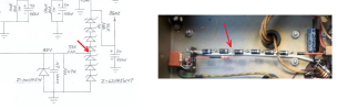

Hi Dave,
I'm trying to reconcile the filament bias portion of the schematic with your reference wiring image:
For the two red arrows in left vs right picture, it looks like you've tapped into the Zener string at 2x up from ground in the reference wiring picture, but the schematic shows it being tapped 3x Zeners up from ground. Am I seeing this correctly? I assume the key point is to deliver ~85V DC as the filament bias voltage.
I'm also wondering what is the purpose of the 100V Zener? I expect it is to keep the surge voltage down to no higher than 100V on startup?

Hi Kevin — Thanks so much for the kind words!
All your assumptions are correct. The main zener string only conducts full current at start up, at which time the voltage at the heater bias tap even after the divider resistors would normally exceed 100 vdc. The 100 volt zener at the tap then acts to limit the heater bias to no more than 100 volts during that time. When the B+ at the top of the main zener string then falls to its normal operating value after the tubes warm up, then all current through the zeners below the bias tap and at the bias tap ceases, and the only current through the zeners above the bias tap is that which flows through the 33K and 47K heater tap divider resistors, which then allows the heater bias to drop to its nominal value of 85 vdc.
As for the discrepancy between the schematic and the wiring shown in the underside pic you reference, that’s simply because I used what components I had on hand, but specified commonly available values on the schematic for anyone interested in duplicating the work. The components I actually used required the tap to appear at the top of the bottom two zeners in the main string, and also required slightly different divider resistor values as well.
I hope this helps!
Dave
