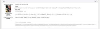

I asked because the pair of Crites (Eminence) CW1526 that I obtained recently measure significantly different from the specs that I found online. It's possible that Crites changed the specs and I just wasn't aware of it. It's also possible that the numbers I found were just plain wrong. Regardless, it is best to measure if you can.
I can still use the woofers that I have, because I was going to Linkwitz-Transform them anyway, but it would have been nice if their measurements matched the info that I had. Next time, though, I'll go with the Kappa-15a or -15c, because their specs are closer to what I want (assuming that they meet spec).
I should point out that the two CW1526 measure remarkably close to each other, which indicates very good quality control.

@Deang, those are for the CW1526C (cast frame). I have the CW1526 (stamped frame). My measured numbers can be found here. The manufacturer's numbers, straight from Bob Crites himself, are attached.

I don't dispute that. But the difference between the published specs and the measured specs in this case approximately doubles the box volume required for Qtc = 0.7071.

It's just a simple sealed-box. The red curve shows the response using the manufacturer's T/S parameters, with box volume sized for Qtc=0.7071. The blue curve shows the response in the same box using my measured values. The green curve shows either one after applying a 3rd-order Linkwitz Transform with f3 at 32 Hz.
