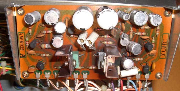

3. Pioneer SA-9100 PS recap and protection relay repair is on hold.
I'm still gathering cap info, measuring cap sizes and trying to source locally, as many parts as possible.

Just a note about the Pioneer repair. The most important thing you can do for that repair is add better heatsinks and use silver solder on the regulator transistors when re-installing them.
DH
Thank you! Based on the cooked condition of that board and its components, do you think I need to replace every damn part? I mean certainly the caps.. but what about the resistors? I've never attempted a SS repair job on this scale before..
