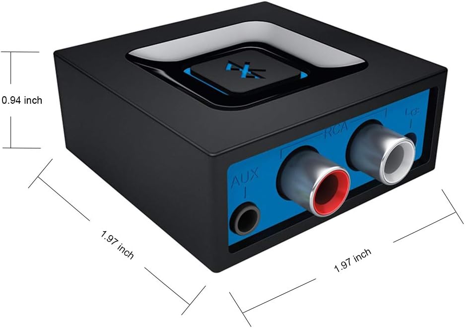

Also with my iPhone I can connect via Bluetooth. I have Logitech Bluetooth adapter which I use with other amplifier
This is what I have. From my cell phone connect to this adapter via Bluetooth and I connect AUX to amplifier.
you can do that too but I will prefer a direct connection with your phone. Connect just one pair of speakers in speaker A position at the top (all four wires)
Okay. Connected the phone through Bluetooth. Disconnected speaker "B". Switch the speakers to "A", put the amp on separated on the back. Play the music. Only get sound on right hand side speaker. When go up on volume I hear lot of static.
