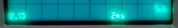

I measure 2vpp with scope

Missing attachements of HB+ and LB+ ripple waveforms edit they are ok, problems my end

The HB+ and LB+ traces are gibber-ish, set time scale to about 1-5mS, looking for a 120Hz "sawtooth sine" waveform
The ripple is caused by the amp(load) running down the stored energy in the caps when the input (rectified) charging voltage is low. Generally class A amps will have higher bias and run down the stored cap energy quicker so higher ripple.

I noticed your timescals was set to 2mS, your traces don't look anything like ripple.

Error should have stated 0.2vpp
For an unregulated supply I previously would have thought that is ok. I'm surprised the ripple on my unit was so low, might be a measurement error on my part.
But shouldn't I see this sawtooth wave?
I am not seeing anything like you have shown on your scope.
Remove the base plate and measure at the solder joints for the main caps. Larger caps are +/-HB. Smaller caps are +/-LB, as normal, cap common pin is GND. The "sawtooth wave" is there, if you can't see it clearly then you have an oscilloscope/tools problem, don't blame the amp.
Try connecting the probe to the 1Khz lug on the front of the oscilloscope... 0.2-1mS time base
