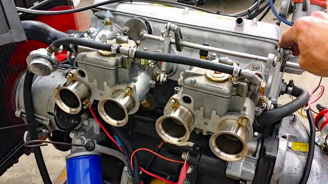

Let me dive off-topic briefly, with a car near to my heart.
I restored a BMW 1602 and 2002Ti many moons ago. After the second set of windows and door seal kits from Germany, a company in Santa Barbara started making quality synthetic replacements. Bless their souls!
The Ti looked like this one. But with a blue exterior.
