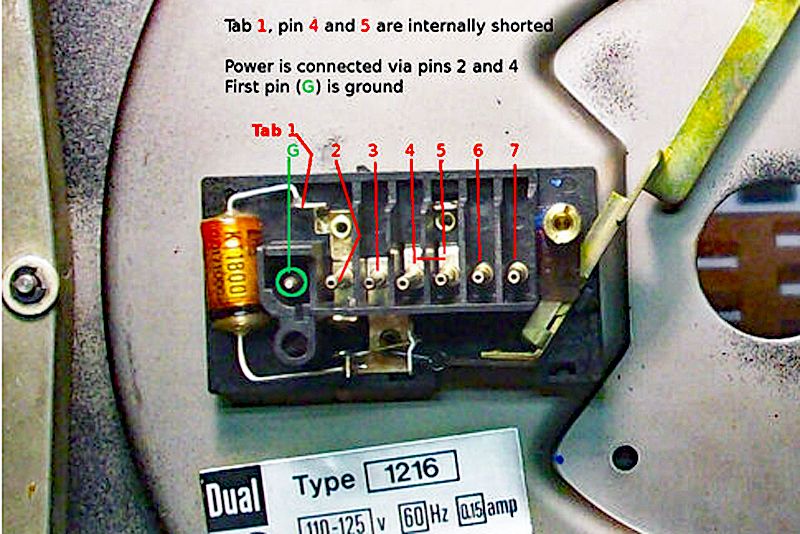

The motor must be running on only 1/2 of the field windings. I still say it is not set into the right pins in the power box.
And I couldn't agree with you more because everything else seems to be within tolerances. Only running on 1/2 of the field windings would explain the slowness in getting up to speed...... @loudnoises says his gets to 33 1/3 in less than one turn of the platter, mine takes 12 turns!!! You also said don't touch anything with regard to the wiring, so I haven't and have been waiting on your kind instructions as to what to do. I can put the wires from the motor on any of the pins that are necessary and you saw in the picture where they are now. The beast is lurking in the details of how to arrange the wires given that there is a switch for 110/220 involved......that seems to be where everyone is stuck, me included, but since I have tested the field coils in terms of resistance and they look good, it can only be that the motor is not getting the voltage that it needs to make the necessary horsepower. Let me know what you think and thanks for your checking in......being stuck is not much fun :dunno:
I have nothing here to reference.
Find which two pins are actually supplying current to a field winding with turntable powered up. But first undo the motor from power block. I have my reasons.
Connect black and green to one pin and yellow and white to the other pin. This easily eliminates the confusing hook up in the power block.
Try to not fry yourself, please.
Thanks guys, I will wrap my brain around it all and see if I can't get it figured out. @NoTransistor, I could use a little more help to make sure I understand you. Your'e saying disconnect the motor from the power block first by removing the four wires from the block. There are four wires, green, black, white and orange that have tabs at the ends which fit over the posts in the power block. To disconnect the motor from the power block means taking these wires off of their post.
Then, connect the power plug and test for voltage with a multimeter set to A/C at each pin, assuming that the common will remain so and that is on pin #2. The next pin is pin #3 and has the green wire connected to it. Next is pin #4, which has the white wire connected to it and is where the hot lead goes from the power. Pin #3 has the orange wire connected and pin #2 has the black. The white and black go to one field coil, the orange and green to the other which is what I discovered when I was trying to measure the resistance so that much I know. So, in order for both coils to be supplied with current, how would one connect those four wires with the hot and the common wires from the wall socket? I'm assuming from your comments that with the power plugged into the power block, connect the green and black wires to the commons pin and the orange and white to the hot pin, or vice versa. How would I do that and still have the motor disconnected from the power block? Sorry, I'm not in my strong suit here but can probably manage if I ask enough questions.

I enlarged the connection box from the link if that helps.

Oh man......I think I may have discovered a problem......I took a bunch of pictures of the power block wiring when I first took the motor apart on January 25 and I just went back and compared those to how I have it wired presently and while the order of the wires is still the same, the original configuration shows no wire on the post between the orange and white wires! Duh!!! The black wire originally was on the #7 post, the orange on #6, then skip #5, white wire on #4, green on #3, nothing on #2 and nothing on the #1 post, which is the ground post. Holy smokes!!! I'm going to go back in and rearrange things as they should be and will report back......I gotta say, though, that even when this table was wired correctly, it still ran slow because I had to set the pitch pointer to about 3 o'clock to get it to run at 33.3rpm.

However......as I'm taking things apart now, I'm also thinking that those two wires, the black and orange, only come into play when the selector switch is set to 220v so there might still be no difference in the speed.....that is, might still run slow. We'll see in a few minutes......stay tuned
OK, the picture tells the story: @NoTransistors was exactly right.....the motor was very likely only running on 1 of the 2 field coils due to the improper wiring!
This is with the idler wheel about as dead center on the 33rpm step as it can be, and the platter spins up to speed in only about 3-4 rotations, so not quite as strong as @loudnoises, but I'll take it! 45rpm shows 45.01, and 78 is at 77.9 and all is well in the Land Of Enchantment.....again!
