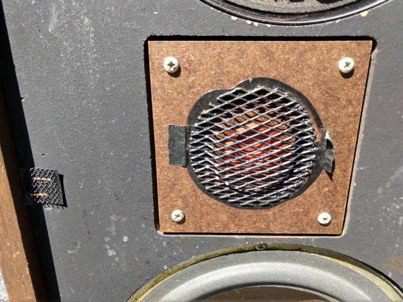

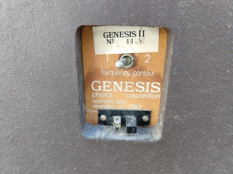

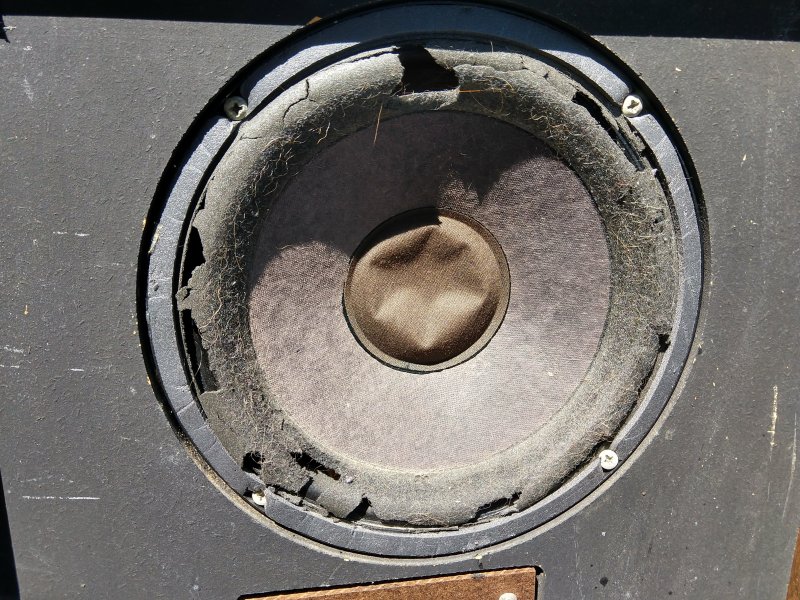

Behold! I have these busted up speakers IN MY HANDS!
From the look of it, someone already re-foamed the passives and the drivers... but then the drivers got ripped up... also, noticed how ALL the dust caps were pushed in... so maybe kids did damage to both, especially since the drivers are at perfect toddler/pre-school kid height.
From the outside, the tweeters and passives look good.
Everything is covered in dog hair (gross). The spring clips on the back are both missing the red cap, for some reason... popped off and lost, maybe?
The little bit i can see inside, though the holes of the one driver, actually looks shiny and happy... so that's reassuring.
THey are in fact the Walnut vinyl clad, and NOT the veneered version... which means sanding and re-staining is out, at least as they are at the moment.

Mine are vinyl covered too. :(
Time to refoam the woofers. You can use suction to pull out the dust caps. Or you can try using tape to stick to the dustcap while you pull it out.
I replace those crappy spring clips with binding posts mounted on a rectangular plate. I get them from Parts Express.
I don't think the woofers are Genesis. They look like Bostons, probably A60s or A70s, based on the dust caps, foam gasket and filleted surrounds. We won't know till you pull the woofers.
The passives look right. Ditto on using a vacuum cleaner to pull the dents out. I use a shop vac with the 2" hose. Once the caps are out, they may have small dimples remaining. I use a small artist's paintbrush to liberally wet just the dust cap and then use the vacuum cleaner again. That usually helps take out the small dimples.

You have the early tweeters, looks like.
