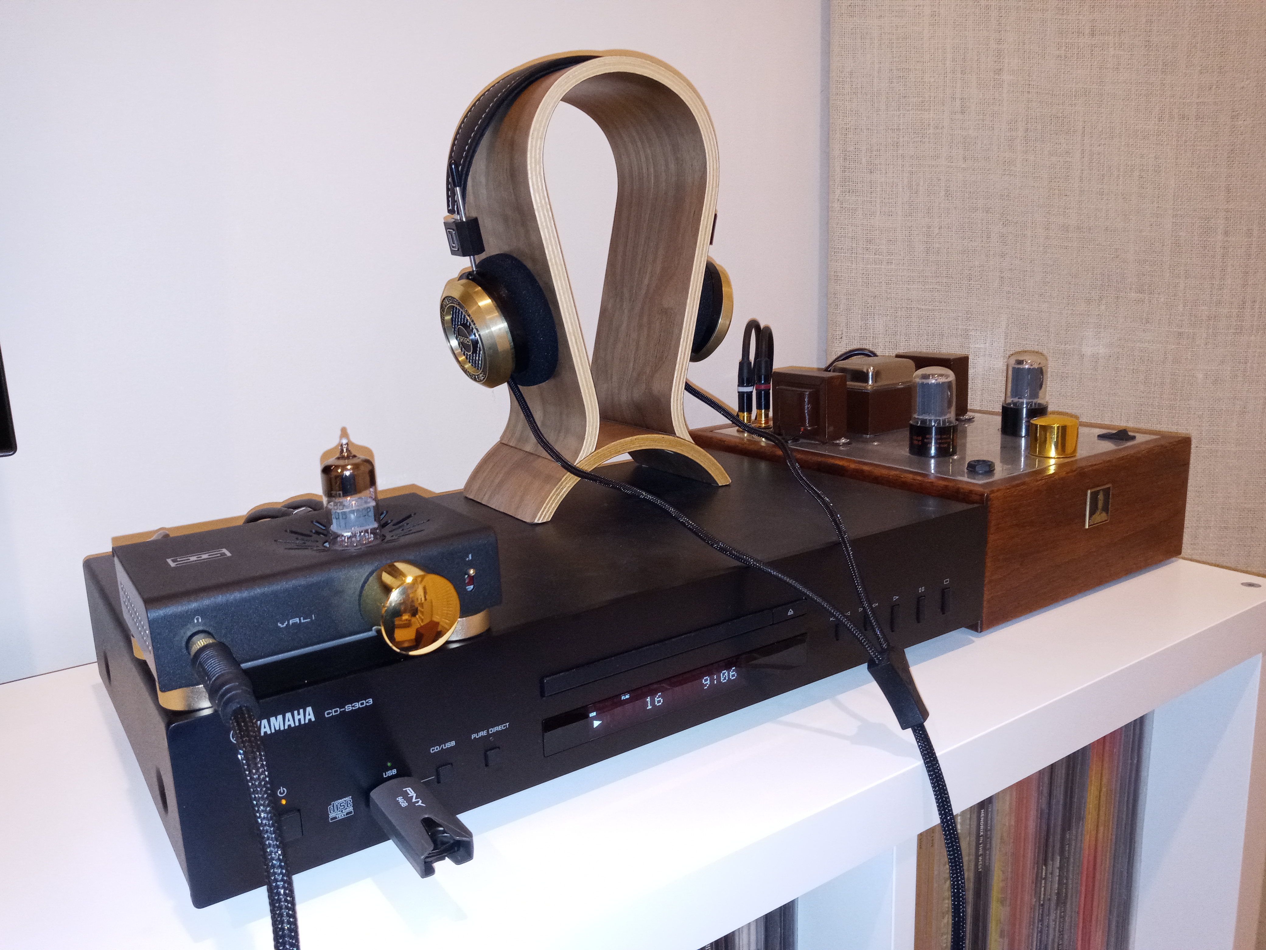

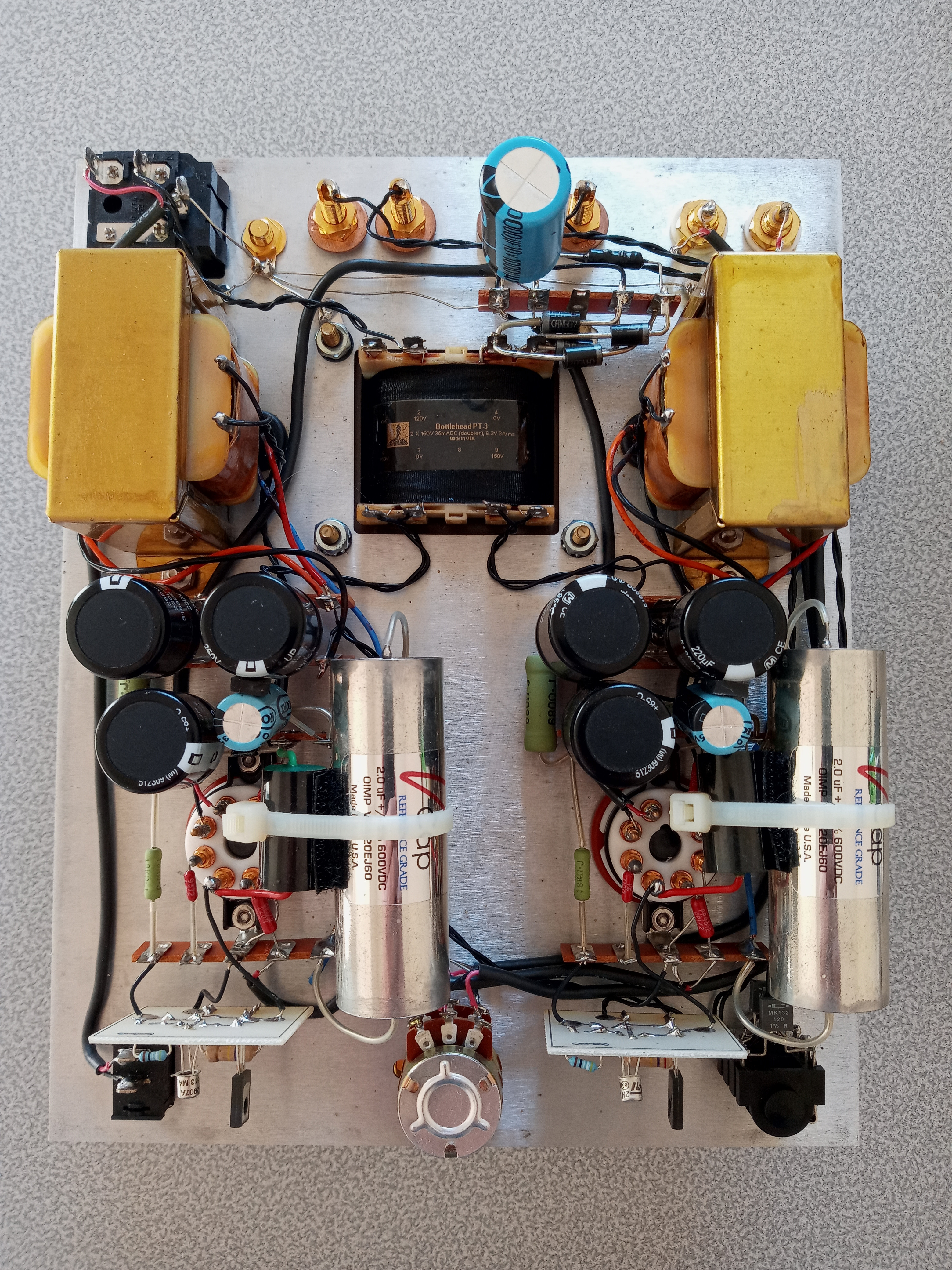

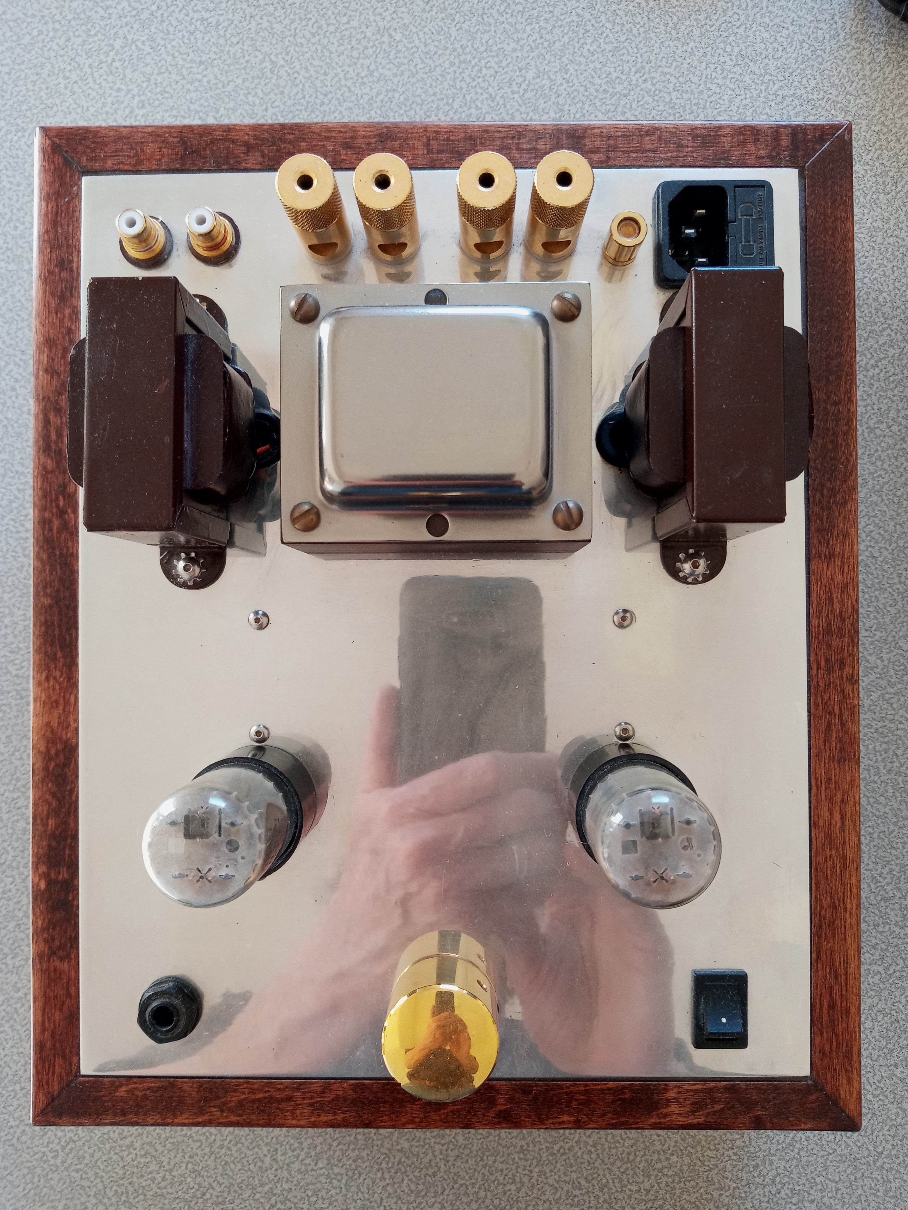

So sweet!Bottlehead S.E.X. amp that I built. 2 watts, 6DN7 tubes.
Absolutely no noise whatesoever fully cranked save for a barely detectable trace of hum. Not sure where that's coming from.So sweet!
What is the baseline noise level like?
Hvala vam!
Very good! Ever measure the mVAC riding on top of the B+ of the power supply?Absolutely no noise whatesoever fully cranked save for a barely detectable trace of hum. Not sure where that's coming from.
No, never tried that. But the same hum is there whether the knob is on 0 or if it's on 11.Very good! Ever measure the mVAC riding on top of the B+ of the power supply?
You need less than 10mVAC to have a silent background (using headphones at full volume to monitor). Tubes have a higher shot noise which is impossible to eliminate.
Sounds good! Indeed, there is a lot of filtering for a headphone amp.No, never tried that. But the same hum is there whether the knob is on 0 or if it's on 11.
My best guess is it's the tubes but like I said it's barely detectable so I never tried to track it down.
