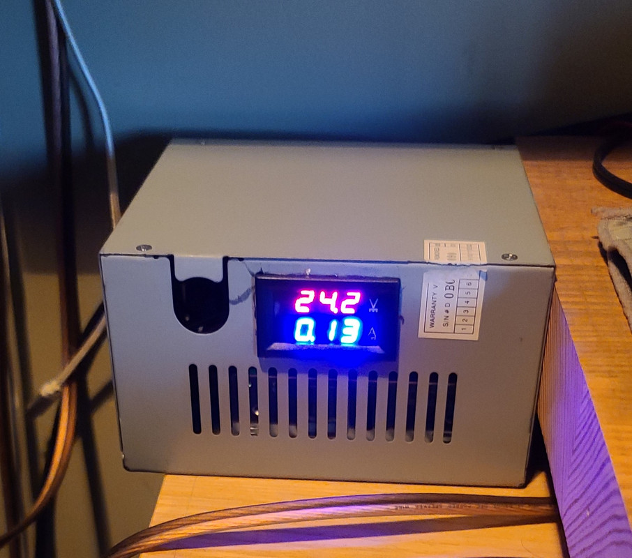

So I decided to recreate Mr. Niyodo's newest YOP-1 "clone" today. Almost, mine only needs a single output and I never used ferrite beads on the output.
I used a Mean Well LRS-50-24 switching power supply, a digital current/voltage meter, the XLR cable from the last power supply I made and a gutted computer power supply.
The computer power supply worked great as it already had a plug in and on/off switch, its just a little ugly.
My multimeter read 24.01V the digital display reads 24.2V so I left it at that. RPM was spot on at 33.33rpm according to the app I have on my phone.
I feel much more comfortable using this power supply than I did with the last one that was running at 25.7V. Now I can do some critical listening of my favorites to see if there is an improvement in sound quality. Eventually I will create a nice pretty case for it, I'll add it to my things to do list.
